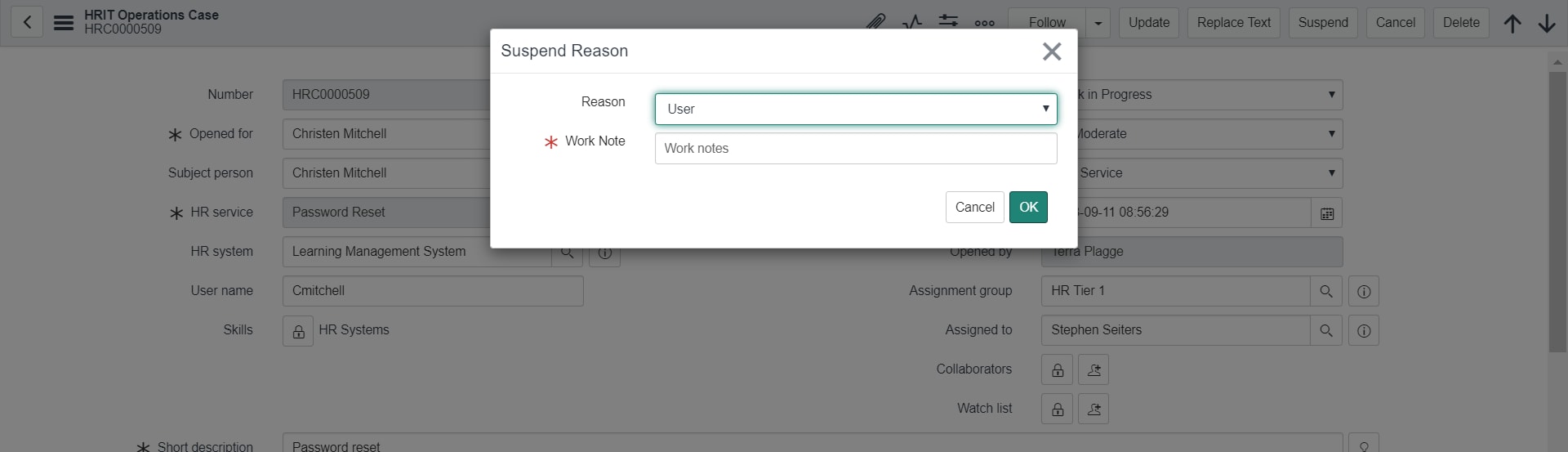

I have a requirement where I need to make Suspend Reason mandatory which pops up when clicked on suspend case button. How can I do that?
Another requirement is to make a value as default one. For example I have item1 to item 4, I want item 3 to be selected by default.
How can I do that?

Look for UI Page: HR Suspend Dialog. You can go through the script it has reason & worknotes that are available & made mandatory on the dialog box.

Hi Peeyush,
Follow below steps.
1. Open UI Page: HR Suspend Dialog
2. In the HTML part of the code replace
<div class="form-group has-error row">
with
<div class="form-group is-required row">
Also,
<label class="col-sm-3 control-label" style="text-align:right" for="suspend_reason">
${gs.getMessage('Reason')}</label>
with
<span class="required-marker"></span>${gs.getMessage('Reason')}</label>
Follow link & replace yourisntancename in the URL & change the sequence for the choices. If sequence column is not present on the list you can add it from List Layout.

Hi Jaspal,
Thanks, the mandatory thing worked like a charm.
But to make a value default, what should I do?
Requirement is choice list should be in alphabatic in order say A, B, C, D and E but B should be default value in Dialogue box reason.
Dictionary override is not working in Dialogue box. Any solution for this please?
