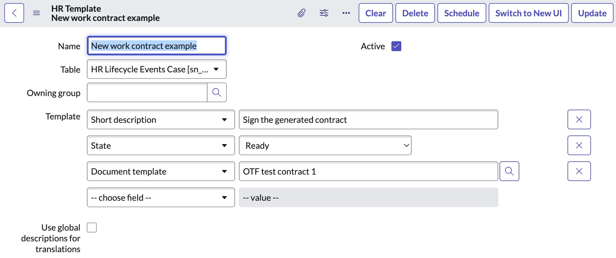

To create a HTML document for signature you need to use the document templates not HR document templates.
when defining your HTML template, add the participants and signatures from the doc template itself.
you can then add the document in your HR service template:
this will create document tasks for the participants defined on the doc template when you initiate the case.
