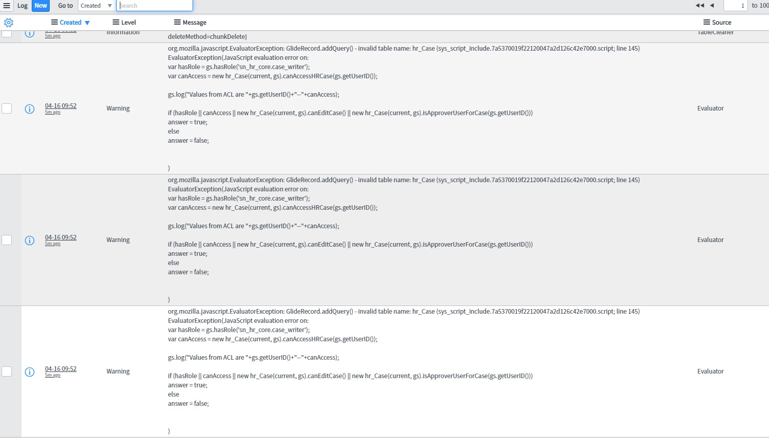

Cleared Cache - ran once with our code - changed to check errors within last 15 min - same errors - here is what I am seeing from the system Warnings: (looks like we are now getting 'invalid table name'
Ah okay. There is a spelling mistake.
Kindly check and correct the table name to hr_case (small c) in script includes. if its already there, then ignore as its a warning and not an error.
Can you also tell me in which script include did you add this code?
Also, just verify by reverting our code to check if that warning still comes.

I will check on that - thank you!
Script Include I added the code to is:
I will work on reverting our code, and see if I get same warnings.
Will post back to you once I get that done!
-Rob
Actually, correct the table name to sn_hr_core_case in script include and check once.
Also, i assume you have added your field u_additional_communication_list in this table only, right.
Mark the comment as helfpul if it helps.
Reverted all code back to was it was - same errors.
I will change the table name as suggested (I was actually wondering about that myself).
The field was added the the Base sn_hr_core_case table, to be extended to all child tables. And has been added to all other table forms, when it comes to HR Cases.
