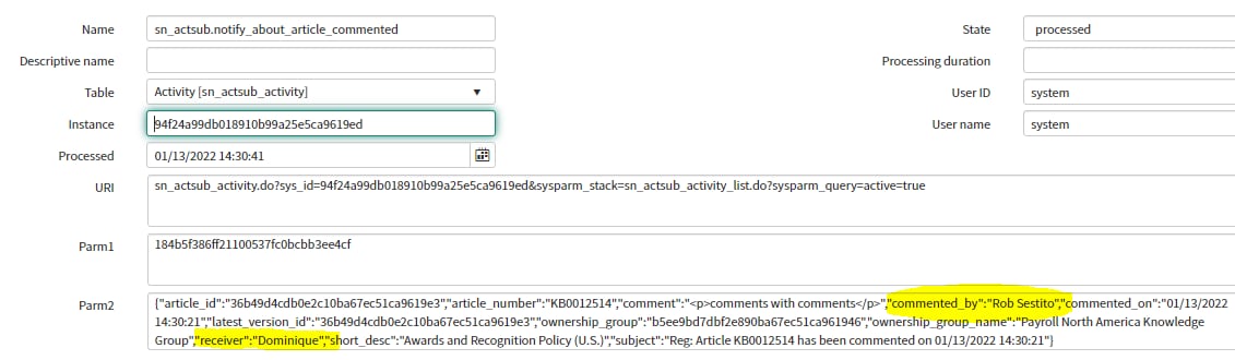

‎01-13-2022 12:26 PM
Hey Tony,
Thanks for replying on this.
When I check into the sysevents, I am seeing that the users are being captured in parm2.
The Notification Email Script on this does have parm2 scripted within it.
The Email Notification being fired by the Event has parm1 checked.
But each user from the sysevents are showing within the parm2 field.
Here is an example of one - I highlighted my comment and the person as a receiver, which is the part we do not understand why.
I think the issue may actually be when was said in the article you sent me.
"The reason for sending out notifications to users no related to the article is that because notifications are also sent to the people who are subscribed to the knowledge base."
