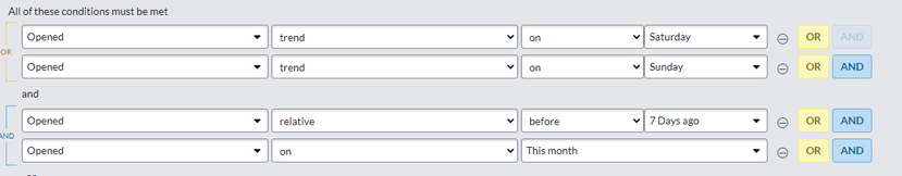

This should be possible through the normal report designer. Please look at below condition which I think should do the trick:
Opened on Saturday or Sunday is = weekends
Opened before 7 days ago exclude last weekend
Opened on this month = month wise (Here you could also do a times series report by per month - if you would like this, the condition should be removed)

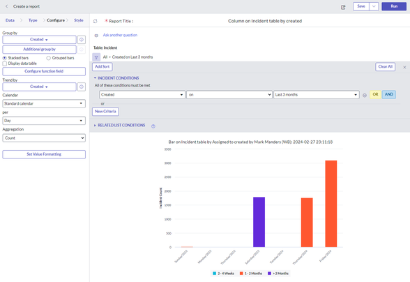

You're not going to get that out of the system, but looking at your requirement: create a column chart on the table you want to see with condition 'created on last three months', because it didn't happen earlier.
If you put the 'group by' on 'created' and add 'per' as day and a count aggregation, it will show you on which day how many tickets were created. Clicking through on the 'saturday' option, you will get all tickets created on a Saturday. For just 3 months, it's easy to just check on the weekends you already have a team in place.
