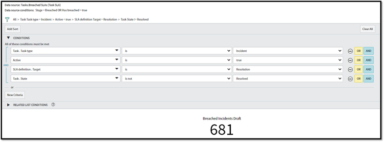

I am Trying to run a report to see how many current open breached incidents we have
  • I first ran the report below from the Incident table to get a starting point and see the current open Incident count of 898.
I then ran a OOB Data Source report called “Tasks.Breached SLAs (Task SLA)” as seen below.
  • I first had duplicate Incidents showing. Each Incident had several entries as they showed the SLA definition of resolution and response for each priority.
  • This prompted me to set the target below to only “Resolution”
I filtered out the state “ Resolved” and hoped to get the numbers close.   For the state, I also tried to filter out “ Closed” but oddly the number went up over 1,000.
Does anyone know what the magic condition is to see the current open Incident count on this Task SLA table? Once I can confirm the numbers match, I will then add the condition " Has breached" to get my out of SLA totals.

Hi @Danny Barker ,
If you just want to see how many open breached incidents you have, you should run the report based on the incident_sla database view with the conditions incident state is not on of resolved, closed or cancelled.

Thanks Anders.  This was close to what gave me the totals I was looking for.  I ended up having to set additional conditions to "SLA.definition.Target - is not - Response"  as I was getting duplicates that showed both response and resolutions.  I also selected "Stage - is one of - In progress, Breached, or Paused"
