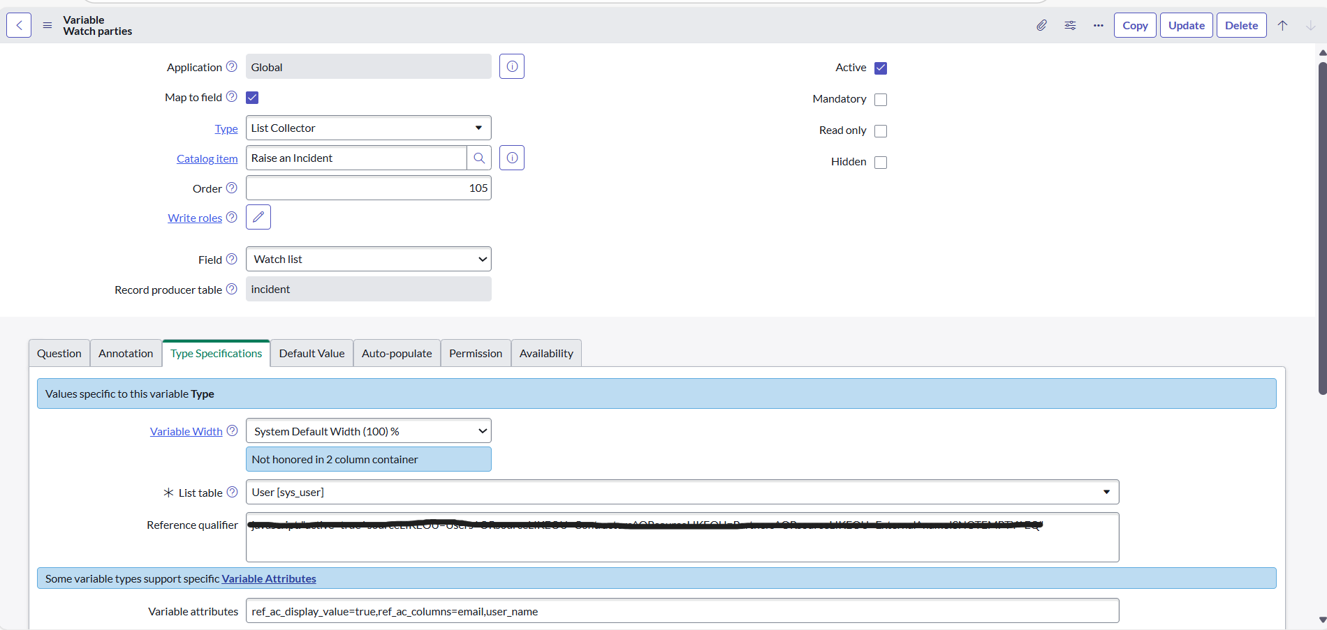

I am facing an issue with a Record producer variable configuration and need your guidance.
Scenario:
We have a variable called Watch Parties in a the item. It is a List Collector mapped to the Watch list field and uses the sys_user table. When searching for users in this field, only the Name is displayed.
This creates confusion because we have multiple users with the same name (e.g., Santhosh Kumar). For fields like Requestor and Affected User, the system shows the email ID next to the name, which helps identify the correct person. We need the same behavior for Watch Parties.
Current Configuration:
- Variable Type: List Collector
- List Table: sys_user
- Reference Qualifier: javascript:active=true^sourceLIKExOU=Users^ORsourceLIKExOU=Contractors^ORsourceLIKExOU=Partners^ORsourceLIKExOU=External^nameISNOTEMPTY^EQ
- Variable Attributes Tried : ref_ac_display_value=true,ref_ac_columns=email,user_name

11-18-2025 02:17 AM
@Community Alums
it should work for reference and list collector type variable
what's your variable type? share screenshots
did you give complete variable attributes like this?
you need not give name field in ref_ac_columns
ref_auto_completer=AJAXTableCompleter,ref_ac_columns=email,ref_ac_columns_search=true,ref_ac_order_by=name

11-18-2025 02:11 AM
Hello @Ankur Bawiskar ,
After adding ref_ac_columns in the variable’s attribute field and testing by typing in the search box, it’s still not working. The requirement is that the user should see both the name and the email when searching for a user.
Your help would be greatly appreciated.
11-18-2025 02:17 AM
@Community Alums
