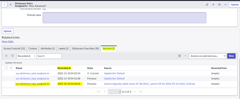

If you want to revert the changes, Add "Versions" related list in your "Dictionary Entry" form.
From the Versions, you can sort it by Recorded at and open the old version/last version.
On the Related Link of version, click on "Revert to this Version" and confirm by clicking 'OK' button.
Verify that Type is reverted back to 'Reference'.
