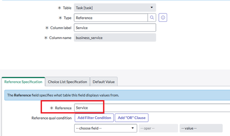

12-12-2024 12:27 AM - edited 12-12-2024 12:27 AM
Hi @sseverance
Just Right click on the field and from the context menu Navigate to configure dictionary and check the Table name. You can add additional service here and it will be visible in your reference field (Service), if it will qualify- reference qualifier condition.
Nikhil Bajaj
12-12-2024 01:10 AM

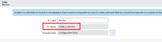

Hello @sseverance
Steps to meet your requirement:
- Right click on the field and select configure dictionary.
- A form will appear, check the reference field in reference specification section.
- Open this reference record
- In the form you can see the table name "cmdb_ci_service"
- You can add the service in this table to make it available in incident form
Note: Table name may vary if the field is a custom field in your case.
