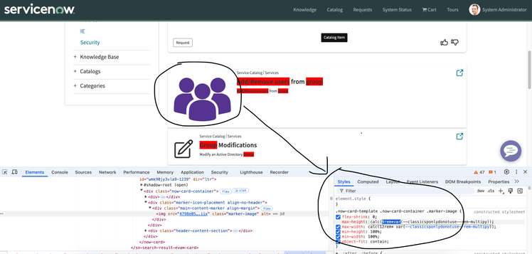

how to modify the image  size(increase) in search result card
can someone please provide the css attribute to increase the size of icon as show in below image.
as the class based css is not working in widget,widget instance, and style sheet.
to be specific i want css variable for  to increase  where do i manuplate these css attributes please guide here

Did you use the article Custom Icons for AI Search Results? It states that while any image URL will work, we always recommend using internal assets from the db_image table. Is this where the Teams image is located? Our out-of-box icons come in set sizes in the Icon Library.
Our documentation on Create a CSS include to override theming for AI Search in Service Portal does not provide options to change the size of the image.
Therefore, I am not sure you can resize these icons using CSS or in the EVAM definition, and the only option is to increase the size of the image.
