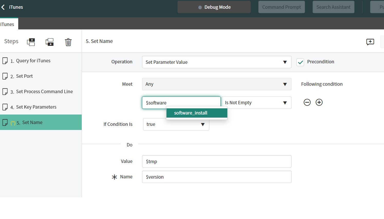

Okay, I just restarted the simulator so I could try instead of from memory. I was able to complete both section 6 and section 10. I'll post my screenshots of what I did.
Essentially completing step 10 definitely will do this. Note: I did restart the mid server as a just in case. Can't say if it would be required but since I did it, I'd recommend it.
First I setup the Process Classification, (you can't add the Pattern to the HorizonalDiscoveryProbe yet, but remember you need to go back to add it in.
Then create a pattern called 'iTunes'
Standard pattern, I just made sure the OS was Windows and the entry points were entered as listed. Make sure Enforce Process Classification is checked.
Going into the Identification section I did the following. To keep it easy I didn't do anything fancy and just opted for simple set parameters after the initial WMI query.
Here's what I did within each of the other steps.
Hit Save and Publish
I went back to the process Classifier and added the iTunes pattern to the horizontal pattern.
Then I jumped to MidServers and synched the pattern. Once that finished (less than a second) I just preemptively restarted the MidServer.
Then I went to Discovery Schedules and ran a quick discovery agains my mid server.
If everything was correct, you should see it running the pattern for iTunes.
I checked the Application table searching for iTunes to make sure it was created, then I opened the computer system record and checked that the app was related to the server.
I validated Step 10, then jumped back to Step 6 and validate it.
Hope this helps to get Step 6 validated.
