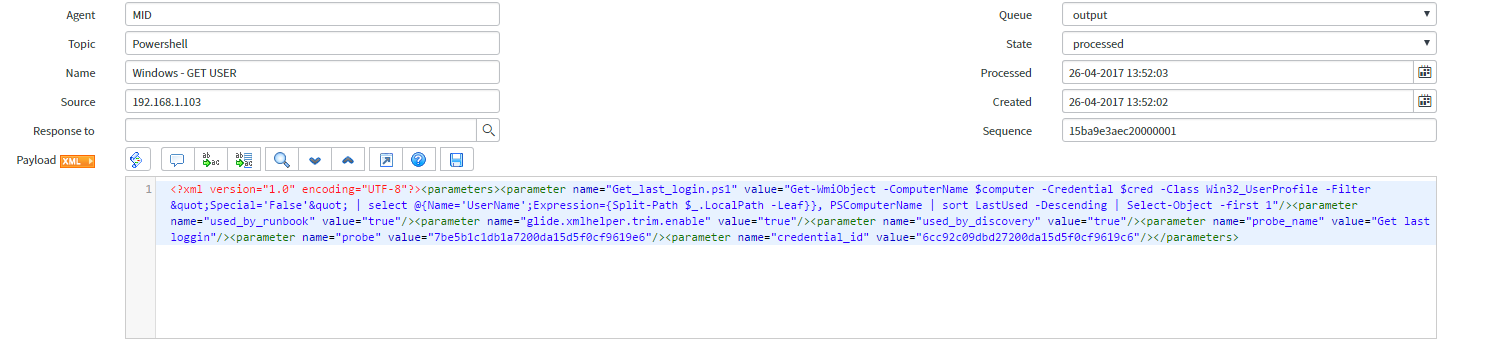

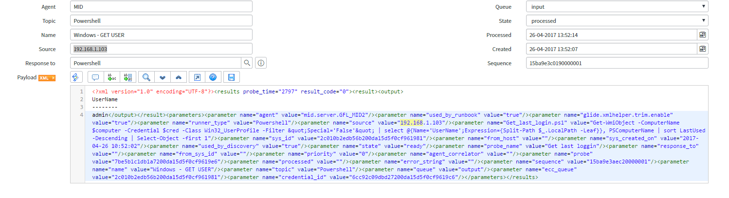

Vivek, at first, we would like to get last logged-in user.
In order to do that we're using the following PS script:
Get-WmiObject -ComputerName $computer -Credential $cred -Class Win32_UserProfile -Filter "Special='False'" | select @{Name='UserName';Expression={Split-Path $_.LocalPath -Leaf}}, PSComputerName | sort LastUsed -Descending | Select-Object -first 1When I am testing probe I have got next result:
Input:
Output:
