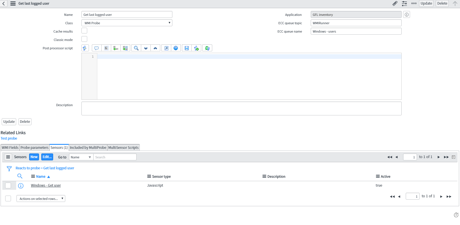

‎04-13-2017 05:52 AM
Hi Vivek,
Your Power-shell script work fine as per our requirements on Windows PC:
Get-WmiObject Win32_UserProfile -Filter "Special='False'" | select @{Name='UserName';Expression={Split-Path $_.LocalPath -Leaf}}, @{Name='LastUsed';Expression={$_.ConvertToDateTime($_.LastUseTime)}}, PSComputerName | sort LastUsed -Descending | Select-Object -first 1In ServiceNow I created new Sensor:
new DiscoverySensor({
process: function(result) {
current.u_last_login = resultWin32_UserProfile.LastUser;
type: "DiscoverySensor"
The question here: how can I use PS-script in ServiceNow? Where should I add keys from powershell script? Is key "LastUser" in correct place in my Sensor example?
Thanks a lot!
‎04-13-2017 10:57 AM
Hi Ivan,
I am sharing you the sensor code also.
Probe command which I used is below, I wrote sensor based on this one so don't change it
Get-WmiObject -ComputerName $computer -Credential $cred -Class Win32_UserProfile -Filter "Special='False'" | select @{Name='UserName';Expression={Split-Path $_.LocalPath -Leaf}}, LocalPath, Loaded, @{Name='LastUsed';Expression={$_.ConvertToDateTime($_.LastUseTime)}}, PSComputerName | sort LastUsed -Descending

‎04-20-2017 02:32 AM
Hi Vivek,
Sorry for the delay.
As for sensor code - all is pretty clear.
But unfortunately I didn't understand where and how I should use your shell-script?
Is that WMI fields related tab?
Thanks.
