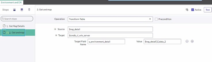

I am reaching out here to get some solution on "to extend the pattern to get the Environment details of servers in my organisation". That details is updated in Registery value of the servers, so I have tried to extend the -Windows OS - Servers pattern.
I am trying to get it via Get Registery Key Operation, but not able to sucess.
Can I get some help on this.

Hi @Ashupakasma
I see you are directly using the actual win server cmdb ci name itself in the registry step, instead you better use a temporary value and then copy it to actual CI in different step.
Though you did it, still I could see the env value is set in CI attributes section in 6th image, so what is the concern here that its not working.
02-22-2023 10:31 PM
Hi @Ashupakasma
You should not change the source table name in steps 8 image, keep the source table also as win server CI name.
Once you do above change, in debug mode go to next step and in right CI attributes view you should see all the win cI attributes filled properly

Hi @Ashupakasma
02-22-2023 11:05 AM
Hey @SiD2 ,
Yes, I have followed what you instruct me, but still not getting the desired result, it's not able to update environment details. attaching step files that I performed.
02-22-2023 10:31 PM
Hi @Ashupakasma
02-24-2023 04:53 AM
Hello @SiD2 ,
Thank you so much for your guidance on my issue. I have followed all the steps and almost achieved the result, the only problem is still the "env" details do not get populating in the CI/CI Form of the Server after running the quick discovery. Even also checked the data dictionary for the "Environment" attribute, checked the ACL, and checked the business rule but no luck. So now we are going to raise a HI ticket most probably for the solution. But again, Thank you so much for this tremendous help.
