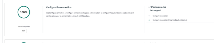

12-24-2025 03:35 AM
Hello @Phillip1 ,
We have resolved this issue with support from HI Ticket.
1. Navigate to Configure the Connection
2. Create a New Connection with the existing details.
If the above information helps you, Kindly mark this as Helpful and Accept the solution.
Najmuddin
