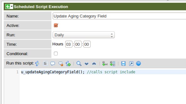

I have a Scheduled Job...
...that calls a function in a Script Include:

Hi Jim,
Hope you can give me a little help here... I've used this to build an aging report for my customer and I'm stuck with two issues that I can not find the solution (the aging column is not sorting accordingly and the scheduled job is not calling the script include, I had to run a background script to update the Aging Category field), below what I've done:
Scheduled Job:
Script Include:find_real_file.png

For the Script Include issue, the name must be exactly the same as the function name.   And in reality, you can skip the Script Include and dump that code into the Scheduled Script.   I did it that way in case I might want to run the code from somewhere else.
