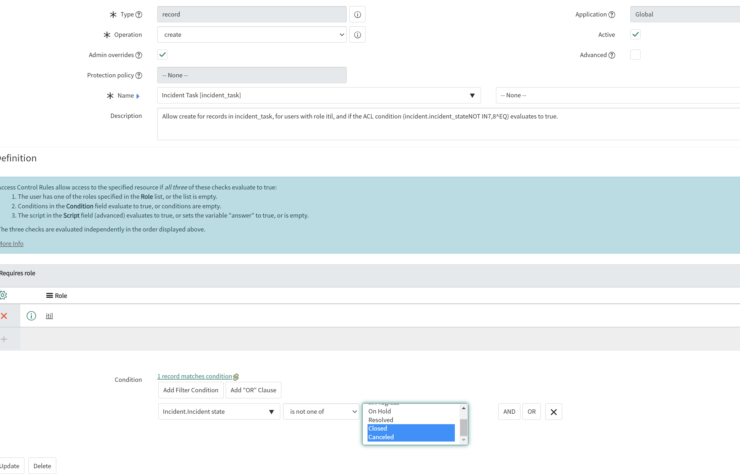

Out of box on my personal developer instance, there's 2 "create" ACLs for the incident_task table. You'd have to ensure in both of those that the user wouldn't pass those ACLs. So you'd need to look at both and see and/or adjust.
I've just tested this myself by disabling 1 of the 2 ACLs, and then adjusting the remaining one ACL (which has itil role involved) to this:
And while the "new" button shows on the incident task related list on a closed incident (that's a separate thing you need to adjust), if they click the new button, the entire form is grayed out and they can't submit:

Sorry, I'm attempting to make sure we're aligned, but my results still don't seem to be the same.
1. I deleted my trial ACLs
2. I ensured that there is a single create ACL on the incident_task table (the one for role: itil)
3. I modified that one ACL to add condition: Incident.Incident state | is not one of | Closed, Canceled, matching your screenshot
4. Impersonating an itil user, they're able to create new incident tasks on canceled and closed incidents. The New button appears, opens to a form with active, fillable fields, and allows them to save a fresh, new incident task to closed and canceled incidents
I don't understand what's missing
5. If I flip it, taking the single create ACL (requires role: itil) and setting the condition to Incident.Incident state | is one of | New, In Progress, On Hold, or Resolved then the "New" button is removed from the incident task form for itil users, regardless of state
