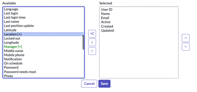

Instead of Personalizing (with the gear icon) you can edit the List Layout (right-click column headers, select Configure -> List Layout) if there is a field on the sn_vul_third_party_entry table that is a reference to the table that is shown in the Exploits Related List.  This will be shown in green with a [+] beside the field label.  Sorry, I don't have these tables in my instances to look it up for you.  If you find such a field, click once on it whilst in the List Layout configuration, then click the expand field / dot walk icon that appears between the Available and Selected boxes. The user table List Layout Configuration is shown here
