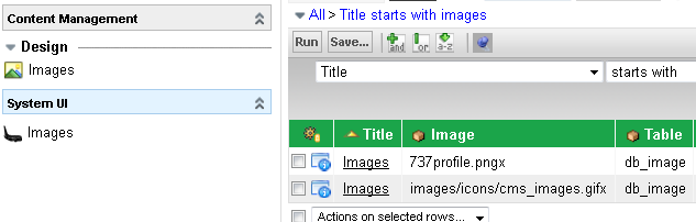

‎04-26-2013 12:19 PM
If you are having trouble selecting your image to be used as an icon, open the application module in list view: In the left filter type "sys_app_module.list". Find the module that you want to change the icon for. Then list edit the Image field, using just the name of your image (plus the "x"), with no subdirectory path.
In my attachment, you can see that I have changed the icon for one of the "Images" modules to the profile of a 727.
