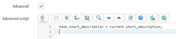

i believe you have used the workflow for that catalog, so if you will set the catalog task short description as RITM short description then this should work.
make the changes in existing workflow catalog task activity.
02-19-2019 06:35 AM
I agree with Harsh, populating the sc_task should be a function of the workflow, not the inbound mail script.
To get the short description of the ritm in the sc_task its current.short_description.

would you mind to put some log here
gs.log('RITM Description is'+current.short_description); then validate what are you getting in log.
your workflow is running on sc_req_item table?
