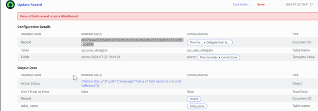

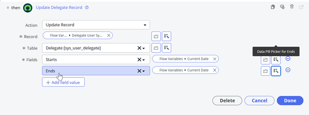

I created a flow to cancel the selected delegations in a list type variable(your_delegate) for a catalog item.
I created a Set Flow Variable reference to sys_user_delegate table.
Script in set flow variable:
and in the update record i'm calling the set flow variable, it is returning sys_ids but not updating it.
getting the below error but for one record its getting working not working if we selected multiple delegates to cancel.
we want to set the end date of the selected delegates as current time.
How we can do this? can someone please help me this?
Sattar
