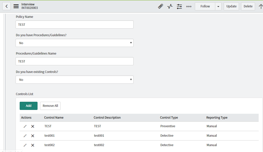

In London and Madrid I can create multi-row variable sets and get them to display in the formatter for the submitted record using a record producer. I want to be able to copy the variable set to another task. I can do this using the question_answer table, but the variables don't get formatted like a multi-row variable set. I tried also creating records in the sc_multi_row_question_answer table and it doesn't seem to make a different. The Row index field can't be the only thing, because I tried creating a record using a record producer that rendered the multi-row variable set correctly, duplicating the records and deleting the old ones and it still would render my new variables as a table.
Any missing pieces in this equation? I couldn't find any other tables that might be involved or fields on the question_answer table or sc_multi_row_question_answer table.

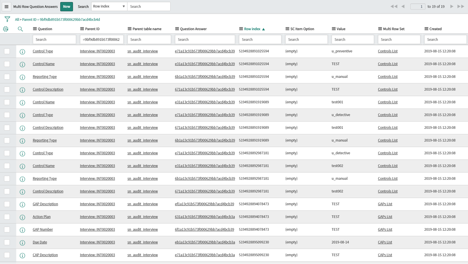

3.- when you execute that UI action it works fine for variables on the record producer but it does not work for variable sets or multi-row variable sets. The variables in the variable sets are not copied into the new record
4.- if you look at the instances in the table "question_answer" for a record that was created from a record producer you can see that there's an instance for the multi-row variable set and in the table "sc_multi_row_question_answer", there is an instance for each variable in the multi-row variable set.
5.- if you modify the script to include also the instance for the variable sets in the table "question_answer" and the instances for variables in the multi-row variable set in the table "sc_multi_row_question_answer", the variables are displayed in the new record but they are not rendered as a table variable set
So it seems, there's another table that we haven't been able to find where we need to create an instance to correlate the record and the record producer, I also tried to use the table "sc_item_produced_record" but it didn't work neither
