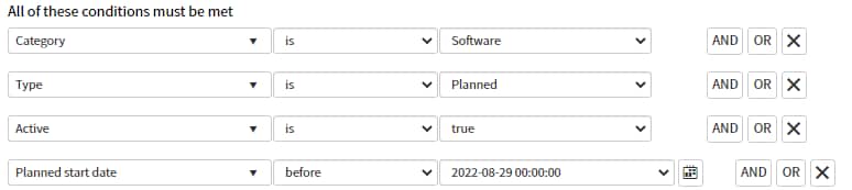

I need to create change task on following condition matched change requests:
I have already made changes in workflow, so new created change requests will have desired change tasks.
Now I have to create change task on already created change request which have old workflow so change task needed to created with fix script.

Your script is not correct. You can try below
var gr = new GlideRecord("change_request");
gr.addEncodedQuery("Software^active=true^start_date<javascript:gs.dateGenerate('2022-08-29','00:00:00')"); //you can update your encoded query as required
gr.query();

08-18-2022 09:55 PM
current object is not defined or not recognized in the fix script due to that reason you are getting the error.
Please try the below code.
Note: PLEASE UPDATE THE VARIABLE "encodedFilter" in the below script then test it in the NON-PROD instance first
var encodedFilter = ""; // Please add the encoded query then execute.
gr.addEncodedQuery(encodedFilter);
gr.query();
gs.info("No of Change request that will be add the change task " + gr.getRowCount());

08-18-2022 11:05 PM
Thank you, this script is working well.
