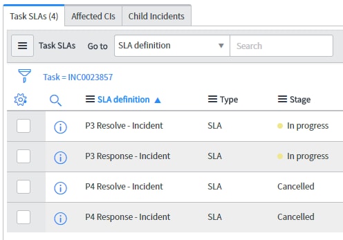

Hi Brendan,
Refer to this screenshot (this should give you a fair bit of an idea):
Also, once you select 'Retroactive Start', you will receive additional options which you would need to select as per your requirement.
