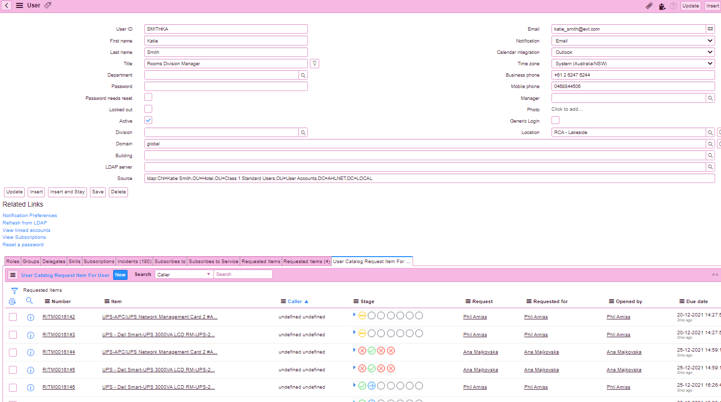

On the sys_user table form I am displaying a custom relationship related list based on the sc_req_item table. The issue I have is that the related list displays all the records in the sc_req_item table.
I only want the ones where caller in the sc_req_item table matches the user in the the current displayed user form.
 e.g, UserFirstName+" "+UserLastName = Caller(in requested Item list)
Below is the screenshots of the required result and also the relationship I have
Any assistance would be greatly appreciated.

Hello Maik,
Yes it looks to be a custom Field u_caller and unfortunately is a string field.
Could I concatenate the first name and last name in the user table and do a lookup on the RITM table based on that value? as in my example above? in this use case it will not be much of an issue if there are multiple matches because of the same name.

Hello Maik
Thank you again for your assistance so far it is greatly appreciated.
The results from the relationship has not quite worked as expected the related list of 11 records below is showing for any and all user records. Maybe I have missed something?
