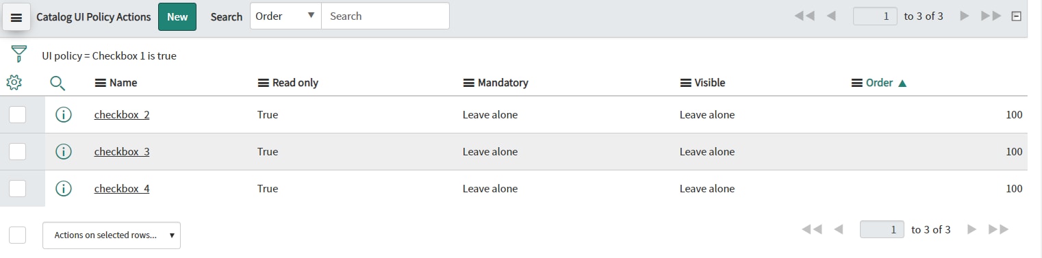

Hi Osman,
You will need 4 UI policies - one policy for each checkbox to be true, and then have the action on each one to mark the other 3 checkboxes as read only. Example:
Then repeat the setup 4 times changing the checkbox in the condition and those in the actions so you have 4 UI polocies:
