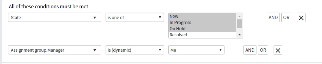

I have updated requirements to change the report filter to:
What would be the best option to change the filter in the current script:

01-08-2019 02:32 PM
In that case update the active query line to
gr.addEncodedQuery("stateIN1,2,3"); // Update the state values
01-09-2019 07:47 AM
Worked as expected ... Many thanks
