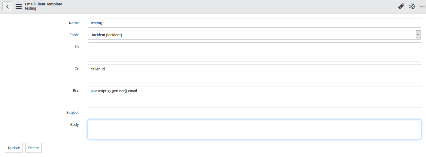

I hadn't tested this before, so I thought that you had to create a mail script with the email.addAddress('cc',gs.getUser().email); and then call the mail script from the template. But I tested some and I don't need a mail script. you can do it all in the template like this:
1. Create a template for the specific table. Here I create one for incident. In the example I also put the field caller_id as a CC just to show how to use that functionality. Then I have written a javascript code to fetch the logged in users mailaddress and put that one in the bcc.

Thanks Goran!   That works well for me (an inexperienced admin).   We'll see if that solution is acceptable to my superiors .
Interesting, if I put the javascript in the Bcc field, that doesn't show up in the Activity tab after the email is sent, so it appears I'll have to keep it at the Cc level.
