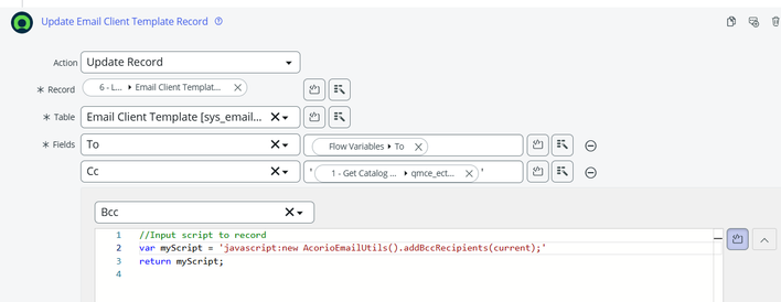

  • The problem I am trying to solve is to store the following code snippet like  "javascript:new AcorioEmailUtils().addToRecipients(current);" to a record using flow designer.
  • I can go out to the table and manually store the snippet no problem, but I need to automate it.
  • Simply using a "Look Up Record" action then an "Update Record" action choosing the field and entering the code snippet is not storing the code.
  • What I do not want to do is execute the code snippet at this time. This code will be executed later as the group members may change over time. I do not want to surround it with '' as I do not want to break existing functionality.
  • The code is piped in from a catalog variable, I tried populating it to a flow variable instead.
  • The below screen shot shows 3 different methods trying to do the same thing, the only one that writes anything is the Cc line but that has the tick marks I do not wish to include.

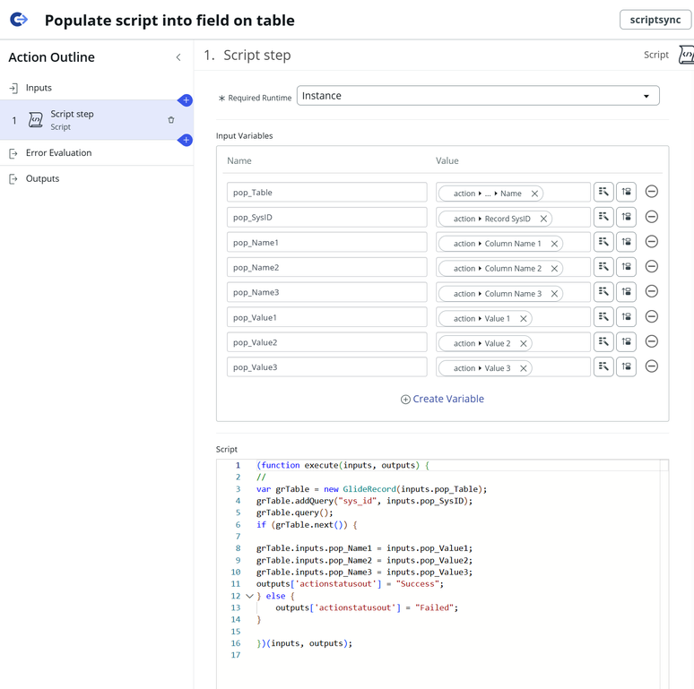

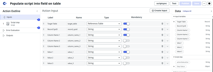

I am starting to go down another path to accomplish the same thing by creating a custom action and scripting the action but not sure if that buys me anything more than what I am getting using the update record function....
Inputs:
Script Step:

strange, I didn't get any error but it didn't update the BCC field
It worked for me using GlideRecord update in background script, you can try to create a custom flow action and use Script Step to do that

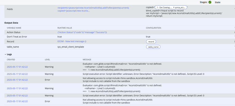

The only value getting stored is from CC due to being surrounded by ''.  Flow designer is trying to execute the code snippet instead of storing it for To and BCC, resulting in the below error.  At the point I posted the initial question I was banging my head at trying to make it work this way, focusing on mimicking how the current process works, but before reading your response today I was pondering the same thing if I could attack the problem from a different angle like modifying the mail script, or like you suggested investigate the process that is triggering this script.
Created                             Level            Message
2025-05-17 01:42:22    Warning      Evaluator: com.glide.script.RhinoEcmaError: "AcorioEmailUtils" is not defined. <refname> : Line(1) column(0) ==> 1: new AcorioEmailUtils().addCcRecipients(current);
2025-05-17 01:42:22    Warning     Script execution error: Script Identifier: unknown, Error Description: "AcorioEmailUtils" is not defined., Script ES Level: 0
2025-05-17 01:42:22    Error     Not allowing access to script include rhino.sandbox.AcorioEmailUtils Script include is not callable from the sandbox
2025-05-17 01:42:22    Warning     Evaluator: com.glide.script.RhinoEcmaError: "AcorioEmailUtils" is not defined. <refname> : Line(1) column(0) ==> 1: new AcorioEmailUtils().addToRecipients(current);
