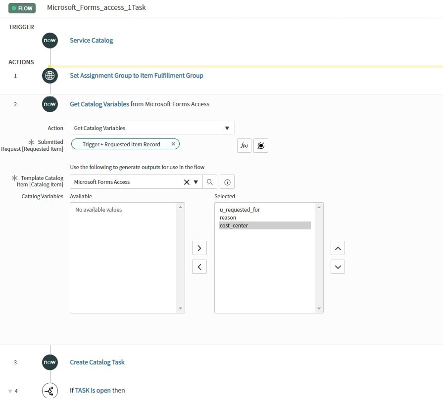

Hey,
we deploy currently in our company a Global Service Catalog wit more than 200 Items.
I have currently the issue, that I need for each Catalog Item "static" Action for "Get Catalog Variables"
So I need for all 200 Catalog Items 200 specific Flows.
Is it possible to get e.g. all Variables "dynamic" from the current chosen Catalog Item?
Thank you very much

06-29-2020 11:07 PM
Hey Anirban,
thank you for support.
I think we are on the right way.
I think that I need a other solution...we want to work in our Service Catalog Requests with "cTasks" also we need the Variables in the cTask (see Attachment)
If I create this Custom Action, I dont got the Catalog Variables.
is there any option?
