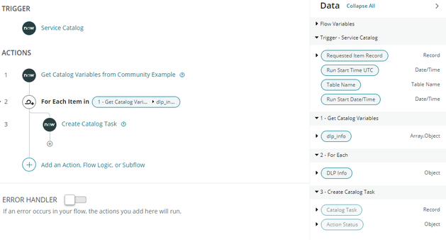

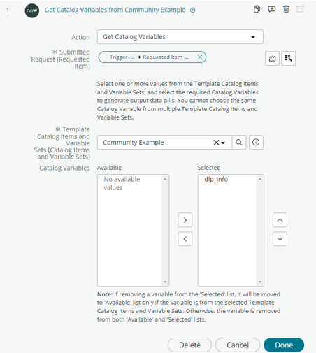

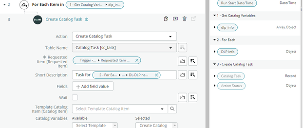

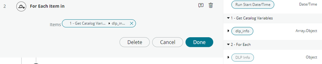

This is pretty easy - within a Flow you can set up a loop on the MRVS.  See screenshots below:

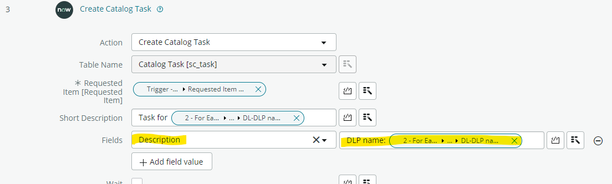

In the Create Catalog Task, click on +Add field value and select the Description field.  Then put in whatever text you want in the box to the right and drag the DLP name data pill from the For Each on the right side of Flow Designer.  Below is an example of what the end result could look like:
