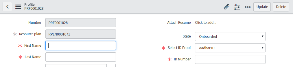

Hello experts,
I have a requirement where we need attachment to be mandatory for the creation/submission of a record- but on a 'File Attachment' type field. I could achieve this using a before insert business rule for the Attachment icon on the banner. But I am unable to do the same for this kind of field. Our instance is on London release. Please provide your input on this.
PFA ss for reference.

Hi Sunil,
Thanks for the reply.
I have the same BR- before insert on my table. But when I try to attach something using 'Attach Resume' field - which is a 'File Attachment' type field it gives me the following error and does not allow attaching using this field. Please assist how can I make attachment mandatory in this case.

Hi Priyanka,
