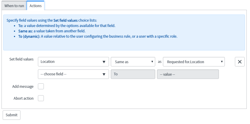

I suggest creating a business rule that executes on insert of the Requests or Requested item to populate the location to the user's location.
Refer attached screenshots

Under "Actions" "Set Field Values" "Requested for.Location" is not an option for me. Everything else in your images I can do.

Hi Steve,
You should do dot walking on Requested for field then select location field to set.
If you don't want to set the field value from Actions then you can write a small script by enabling Advance script option.

Thanks, that was the problem. I needed to dot walk and it's working!
