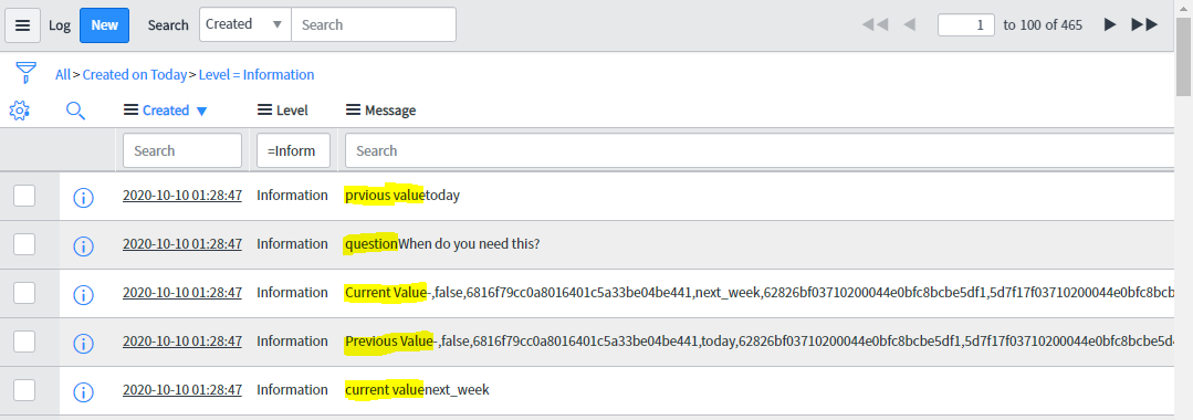

4.To check,
Open any RITM, change the value of any 1 variable (for testing purpose)
Go to logs.
You will see the record which contains
Question: Name of the variable
Current Value: Current Value
Previous value: Previous value that you modified.
If and Only if the value if modified/updated.
Please check the below scrrenshot
I am working on how to send this value in Notification,I will do that also,but need some time.till that time you can try to implement the provided solution.

Hello Sironi,
Did you check the logs from above screenshot?
You can see we are getting current value and previous value if and only if it is changed.
Please implement this solution till here,and check you are getting the same result or not.
If is giving you correct value ,then we can create notification to send the variable detials to the user.
I already implemented the solution on my instance
