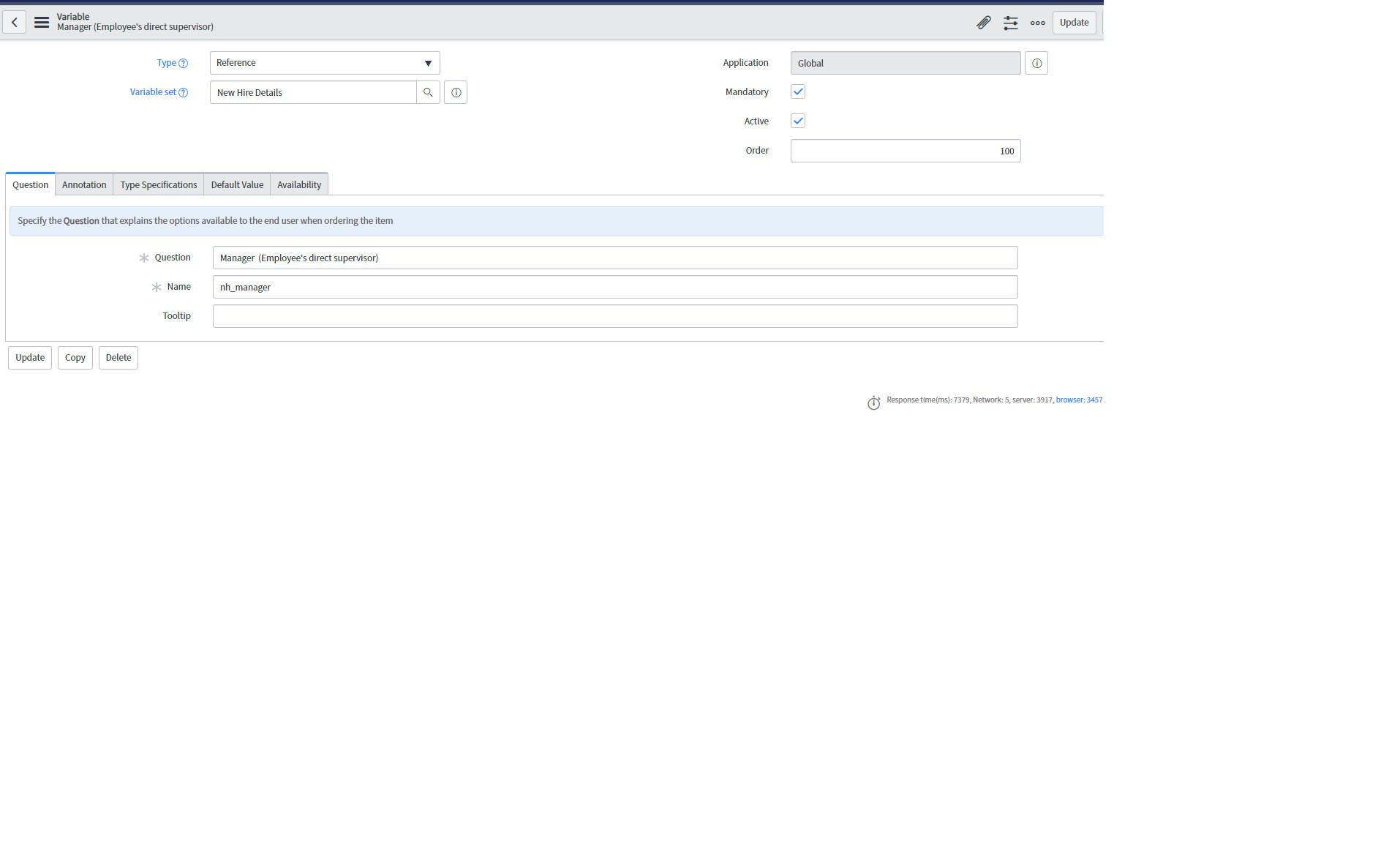

I am working to modify our existing on-boarding Catalog form. Here on our form we have field called "Manager (Employee's direct supervisor).
What I am  looking for  is when a manger himself is opening a request then it should skip the Service Catalog Approval process and create a task , Otherwise if request is opened by someone else it should trigger approval process to manager mentioned in "Manager " field. In order to achieve this i have tried below mention script but somehow it skipping the approval in both scenario, when raised by manager or by others.

 On - Boarding form example
Variable name of Manager field
