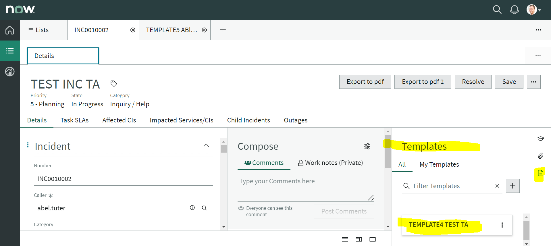

I want to Restrict all users from editing Template created by someone else
tabrez ahmed
I want to put limitation on "Template" created by any user and that template should not be editable by anyone except the creator should be available if selected "global "but read only for all users
