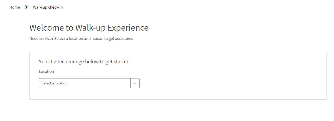

However, contary to this image found on another topic, the tab "Schedule an Appointment" doesn't appear, amond some other informations.
I would like to understand why I'm redirected directly to a location id without to be asked for the location I want in a dropdown list, why the component to join a queue and Schedule an appointment tab are not displayed on the page, even in the original widget.
