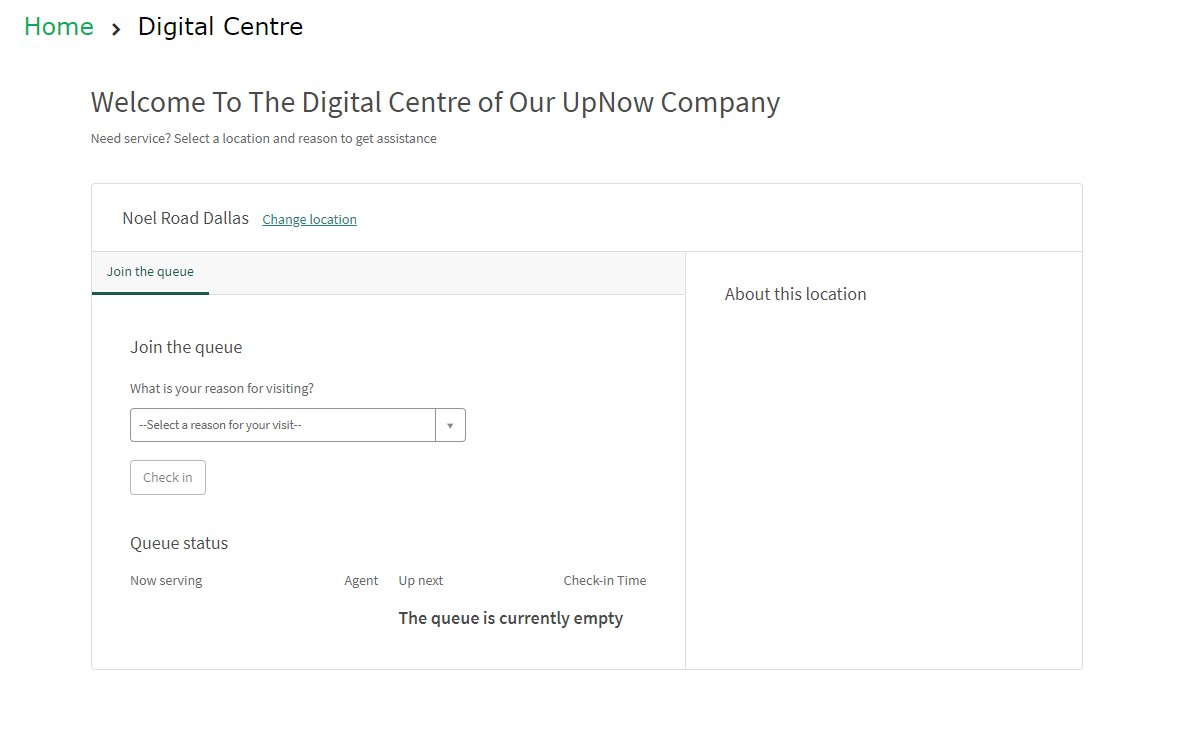

It's made. Now, I'm always led directly to a location, but I have a screen like this with a link to do appear the dropdown list and change the location.
I have still not the Walk-Up Appointment Tab, but I have the dropdown list to choose a reason for visit in tab "Join a Queue" and a button "Check-In" to join the queue.

Hi. I have tried to create a Schedule and add to Location as you said, but it doesn't seem to work.
I still obtain a blank page at the level of the About My Location widget :
I have selected a "8-5 weekdays excluding holdidays" schedule in Walk-Up Experience > Administration > Schedule and I added to my Democracy Lane Location, but nothing displays beneath About Location.
