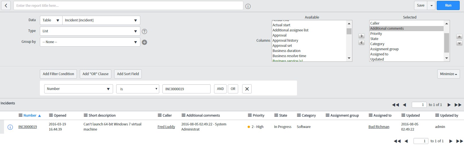

I have a request to include either the last work note or last additional comment on a list report. I know how to include the last journal entry within notifications but I am not seeing a way to do this on a report.   Any advice would be appreciated.
-Chris
Thank you for the clarification. I was able to reproduce this (given some more sample data.)
The only way I can see that you can do this is to have a secondary u_comments (string) field and a business rule that maintains it. Something like
current.u_comments = current.comments.getJournalEntry(1);
This gets the latest entry and overwrites what ever is in the u_comments field. Use that on your report and you should be good.

I'm still only seeing the last comment (Helsinki.) We're clearly doing something differently. Here's what I did:
  1. Reports> View / Run
  2. Create a list report on the incident table
  3. Adding the Additional Comments field
  4. Click Run
Share the steps you are doing to produce all additional comments please.
