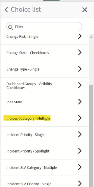

(2) Add the interactive filter to the dashboard by selecting the plus sign (top right of the dashboard) and add the interactive filter (interactive filter > choice list > Incident Category - Multiple).

Thanku so much. It is working fine now.
