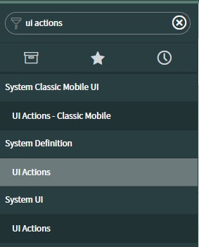

For the second task open Ui Action with the filter stated as per the below screenshot. Open the record and in condition just add the below code highlighted one is modification done.
"current.incident_state != IncidentState.CLOSED && gs.hasRole("itil,sn_change_write") && gs.fieldExists('incident', 'rfc') && current.rfc.nil() && (current.priority==1 || current.priority==2)"
After this, you know the process just hit validate and you are done with this task.
