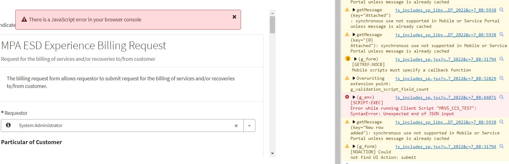

I am trying to compute the total value of 1 of the column in the MRVS and displayed onto a variable in the record producer as shown below:
I have followed the guide from the below link but to now avail.
Not able to retrieve Multi Row variable set data using onSubmit client script - IT Service Managemen...
From the below catalog client script, I have encountered error due to the parsing of the g_formGetValues. I also found out that the result of console.log(g_form.getValue('billing_request_insert_details')) is returning empty values despite I have filled the relevant field in the MRSV.
Catalog Client Script
MRSV in preview
Error in Console
Details of MRSV
I would appreciate if anyone could assist on my problem.

Hi in your client script line number 6 should be a variable name of your variable not Variable_name
.multiRowVariableSet[i].Variable_Name; // replace Variable_Name with your actual variablename
Harish
Hi Harish,
Thanks for your prompt reply and noticed the discrepancy.
However, the error remains.
You need to check other part as well . Where ever they have mentioned variableName replace it to your variable name
Harish
The error happens before the for loop.. Apparently, the value loaded onto the variables in the MRVS is not picked up somewhere in the backend.. I am not sure if any configuration for the MRVS is incorrect
