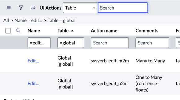

My UI Action list filtered on the name = 'Edit...' and table = global looks like this:
so out of these two choices, the first record is the one you want to duplicate for your table.

Since you haven't specified an Edit... UI Action for your custom m2mtable, the one one the GLobal table is being used.  If you want to change the behavior of this button for this related list, view the UI Action record with the Action name sysverb_edit_m2m, change the Table name and Insert and Stay as a starting point.  Now you will have an Edit... UI Action for your Related List that you can customize without messing up all of the other ones.
