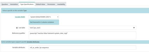

Hi @VikMach ,
I don't think you can achieve sorting on backend catalog form but it may work in portal.
Try below option:
Reference qualifier: javascript:"inactive=false^element=system_inter_mgt"
Variable attributes: ref_ac_order_by=sequence
If Variable attributes is not visible on your form then go right click on header > configure >Form Layout and select that field to the form.

@anubhavritolia - I need this in this order. Here you go.

@anubhavritolia - No Anubhav, that didn't work either. I tried to place the ORDERBYsequence in different places in the filter condition that doesn't do the trick. I'm wondering if something has changed or has it to do with my Choice List itself?
