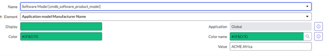

In the pic1, the colors are showing up as per the attached screenshot but I am not sure where it is defined becasue when I check in the chart color table I cannot find them(screenshot attached). So, I defined one for that table and dot walked to that field but it is also not reflecting on the report.

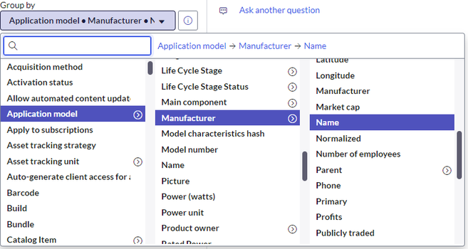

Sorry I didn't see this earlier, but it's due to your group by in the report:
As an example I made below in my PDI:
Best regards
Anders

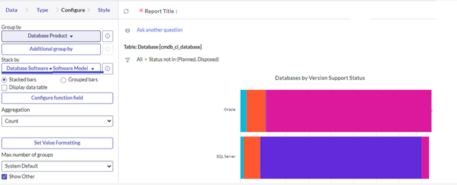

In the report, it is showing that the stack by is for different 'Software Support Status' as shown in screenshot below:
1. I am wondering where are these colors defined because in the chart color table I cannot find them with the [cmdb_ci_database] table
2. I have defined some different colors by dot walking but it is not working so not sure what is the issue.
I tried to define color for the 'Group by field' also but it made no difference.
