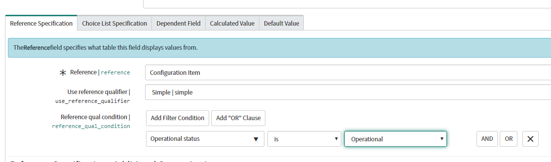

I am in the process of doing a major cleanup of our configuration item list. OOTB there is a reference to cmdb_ ci table for this field. Along with that, there is a dependency set on the field with Business Service.
If an item from the cmdb_ci_app appears in the list. How do i set a filter so that anything with a Status and/or Operational Status of Retired is filtered out. This capability should be out of the box.
I found the issue. On the task table, there is a reference to all the tables that use the cmdb_ci field  under the dictionary overrides. no matter what i put into the reference qualifier, it would not work. thanks.

Could you clarify your question a bit more? Is it about just filtering in a list? Is it about a reference field on for example Incident which should be filtered?
If it's for example, about a reference field, you could do something like below:
