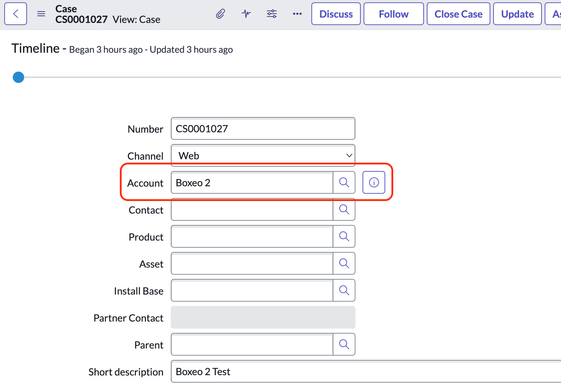

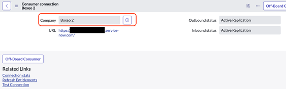

On the Case is the Account set to an Account which has an Active consumer connection?
What it means? I didn't get it.
10-23-2024 07:59 AM
On the Case the Account is the same as the Company/Account in the Consumer connection record. And the Consumer connection status is Active Replication.
10-23-2024 09:05 AM - edited 10-23-2024 09:22 AM
Yes. those are same.
