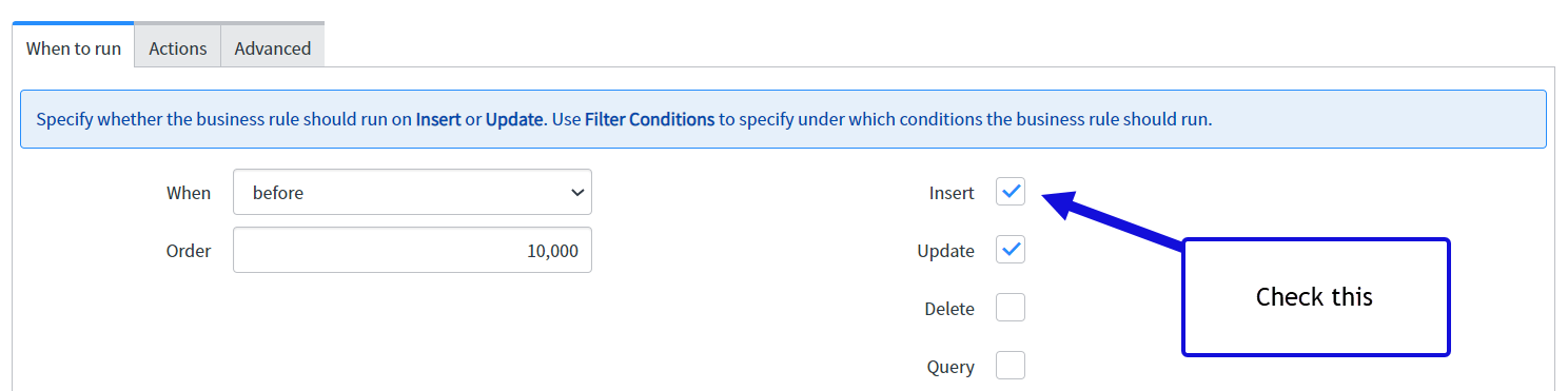

Hi Saurav,
The link was helpful; note that in addition to updating the Business rule "Start FlowDesigner Flow" for the table sc_req_item to remove the  "request_approved" condition, I also had to check the insert box on the "When to run" tab.
Thank you for responding to me, it certainly helped!
