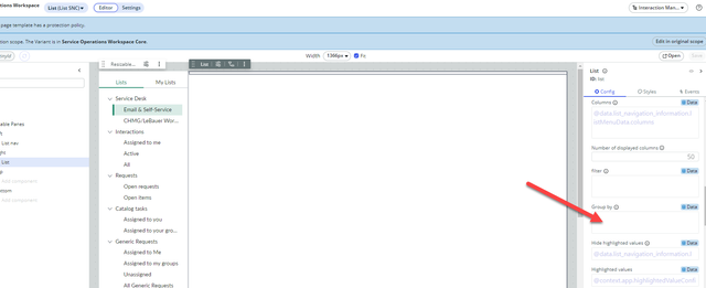

I have resolved this. What I noticed is the 'Group by' data is not being transferred into the List SNC page because the field was never added to the configuration:
The way I resolved it was as follows:

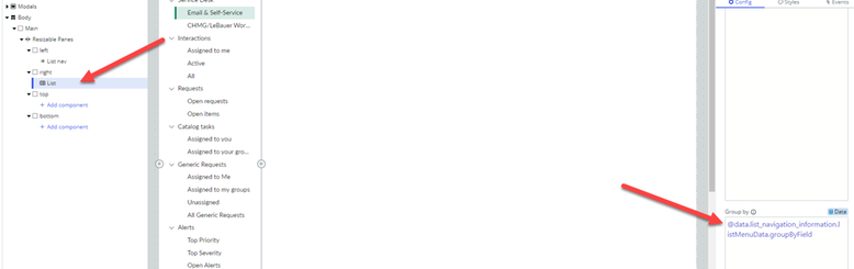

1. From the settings you will create a new page variant.
2. Modify the order, of your variant, so it occurs before the OOTB List SNC Page
3. In the UI Builder editor, for your new page variant, click on the 'List' element within the 'right' container
4. Add '@data.list_navigation_information.listMenuData.groupByField' to the 'Group by' field:
5. Click 'Save'
6. To test, impersonate a user who does not have admin or meets the audience you have chosen to specify for this (I don't reccomend since List SNC is used througout Service Operation Workspace.)
Couple Notes:
- I did run into an issue where the filter did not initially save so I had to go back and add that and ensure both entries stayed.
- This does lock you into a customized page variant, but if you have no issue with the look and feel of this or are familiar with UI Builder then by all means proceed if you don't want to wait on ServiceNow to fix it.
