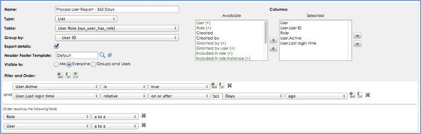

‎12-06-2016 11:37 AM
Configuring the report as shown here seems to be the best answer to my question.
Four Primary Components:
- Data > Table > sys_user
- Sys ID > is > javascript:getRoledUsers()
- Active > is > True
- Last Login Time > Relative > On or after > 365 > Days > Ago
One Secondary Component if Applicable (Not Shown):
- Filter Out Non-Fulfiller Roles
In our case, we currently don't have any users that utilize a non-fulfiller role ONLY. However, If you do, and you subscribe to a Fulfiller user model, it might be a good idea to filter these out as they don't utilize a license according to ServiceNow. Please consult your order agreement and ServiceNow representative for confirmation.
Using this report configuration will eliminate duplicates as it is pulling individual users from the "sys_user" table instead of users and their individual roles from the "sys_user_has_role" table. You can then add related columns like department to gain more insight into who is using licenses.
If you have Performance Analytics (PA), I suggest using it. It will allow you to practically eliminate the need to export this report to Excel for post-processing and analysis.
Thanks to all who contributed to this thread and other like it as this solution would not likely be possible without you.

1. Best way to monitor license usage is to generate a report from the [sys_user_has_role] table to report on users that are active .and. have logged-on in the previous 365 days .and. excluding all non-fulfiller roles (Role is not "non-fulfiller role name 1" .or. Role is not "non-fulfiller role name 2" .or. and so on). This report may already be in your instance under the name "Process User 365 Report" or similar.

- The biggest issue I noticed with this report is that it is grouped by User ID. This is a problem for several reasons:
- The report is too large for export, I received the following message, "The export you requested contains 48709 rows which may take a long time to return. It is recommended that you let the system email you the results instead of waiting."
- I am unable to see user details such as department. This is needed for departmental usage analysis. Different departments contribute to the overall cost of ServiceNow based on usage.
- It would be nice if you could aggregate the results by distinct count of user like you can in the speedometer report. This would create a much shorter list that is easier to analyze while retaining all the functionality of the list report.
